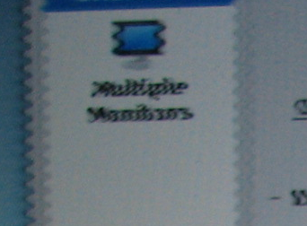

                    The outstanding problem is when I have a second monitor connected. On my desktop, which has an NVIDIA card, all works well and I can boot the system with the monitor connected. For my laptop, which has an ATI Radeon X2300, I can only connect the second monitor after the system is booted using System Settings>Display. If I have the second monitor connected on startup, it is not automatically connected and the display size is not set to the "Auto" values . When I use System Settings>Display to set the "Auto" values, the second monitor becomes active unfortunately the display shimmers as shown in the attached image.
