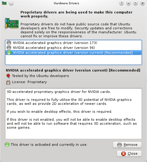

        Through the repositories. Using the "System > Hardware Drivers" program.

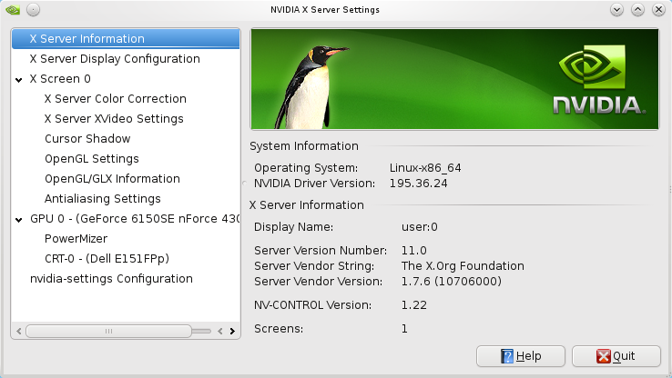

                        Hmm. I am wondering if you are really running the nvidia driver, or the nouveau driver.
                        Try running nvidia-settings (you might have to install it) and see if it comes up. If it does, you are running the nvidia driver.
                        Reason I mention this is that usually, if the nouveau.ko is present, nvidia won't load, and visa versa.

                          Output of
                          user@user:~$ nvidia-settings
                          Boot Info Script
                            Re: nVidia driver installed. Stopped at terminal login.
                            That looks right. I'm surprised at the notion that the nouveau driver is still present -- I thought jockey-kde was supposed to remove that if you installed the proprietary driver.
                            Another thing you can do to check the status of your Nvidia driver is run
                            glxinfo
                            -- it should ouput the fact that it's using the Nvidia driver, the version, and a long string of GLX capabilities.
                            If you decide to rip out nouveau and follow my "Method 2" guide, I would get the current Nvidia driver version, as listed here: http://www.nvnews.net/vbulletin/showthread.php?t=122606
