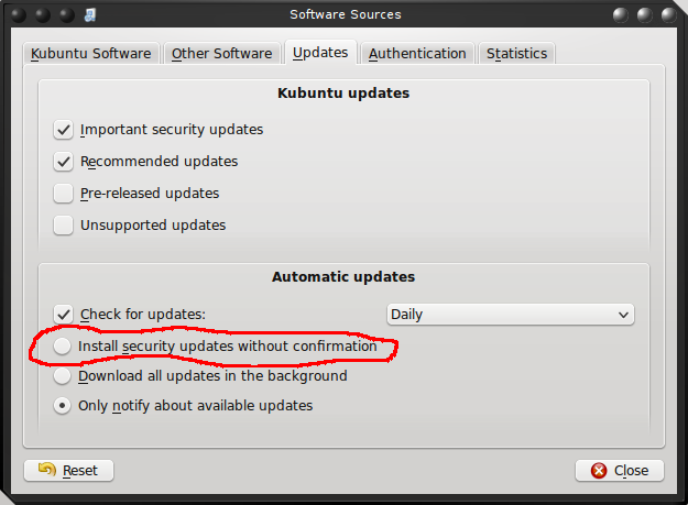

        My settings. I am always 'notified' of updates - I have to perform the actual fetching and installing of any updates.

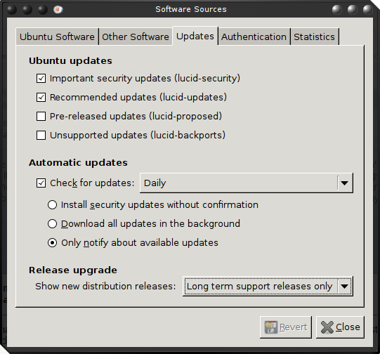

          Mine look just like that (except for unsupported updates). I notice that there is an extra option and other minor differences in the "repositories" dialog's "updates" tab in the synaptic version, so i guess Kpackagekit isn't using the same window, it just cloned the synaptic window? Anyhow, my via-synaptic config looks just like yours, so we'll see if my system behaves itself now that i confirmed those settings through synaptic... i unset and set a couple values just to be sure it all registered...
