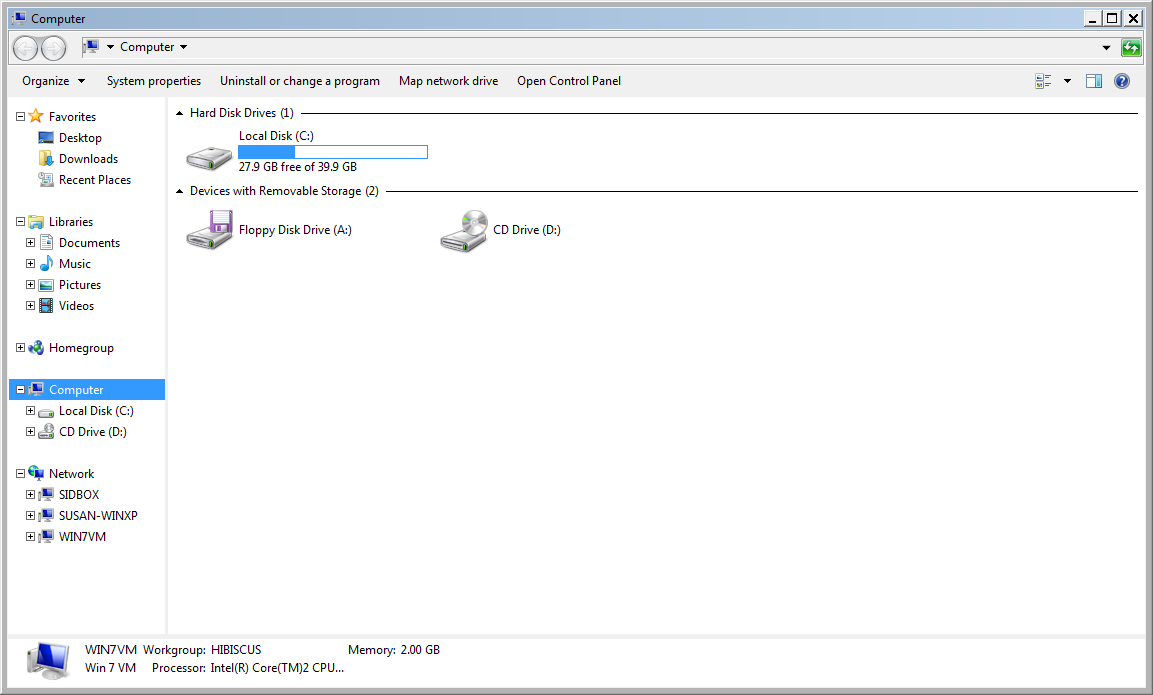

              OK, we're behind a router (with the factory default address changed), so I nuked all the security-related settings. Here's what's left:
              dibl@lucid:~$ cat /etc/samba/smb.conf
              [global]
              workgroup = HIBISCUS
              interfaces = eth0
              map to guest = Bad User
              security = share
              [Data]
              path = /home/dibl
              read only = no
              guest ok = yes
              case sensitive = no
              strict locking = no
              force user = dibl
              [Canon_iP6220D]
              printing = cups
              path = /var/tmp
              printable = yes
              guest ok = yes
              guest only = yes
              [Documents]
              path = /home/dibl
              read only = no
              browseable = yes
              guest ok = yes
              That's it. From the Windows VM, what I see looks like this:
              [img width=400 height=241]http://img820.imageshack.us/img820/329/win7sambaview.png[/img]
              You can see the other computers in the lower left of the screenshot. "Win7VM" is the VM that I took the screenshot from. "Sidbox" is the host running VMware Player. The other one is my wife's Win XP box.
