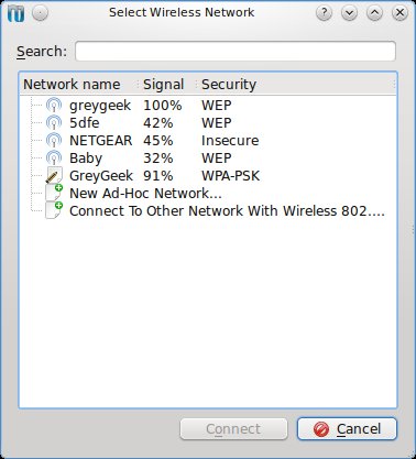

    Unless you've changed it, the default network manager is KNetworkManager. Right mouse on the icon in the system tray and chose "connect to other networks". A dialog will appear listing the existing access points and two other options: "Connect to Other Network with Wireless 802.11..." and "New Ad-Hoc Network".

        Here is the dialog I am referring to:
