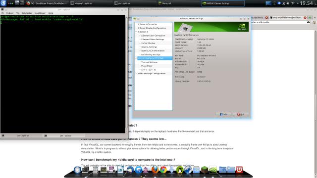

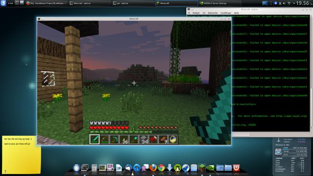

    Installed Bumblebee, success!
    Click image for larger version.
    Tanks!
