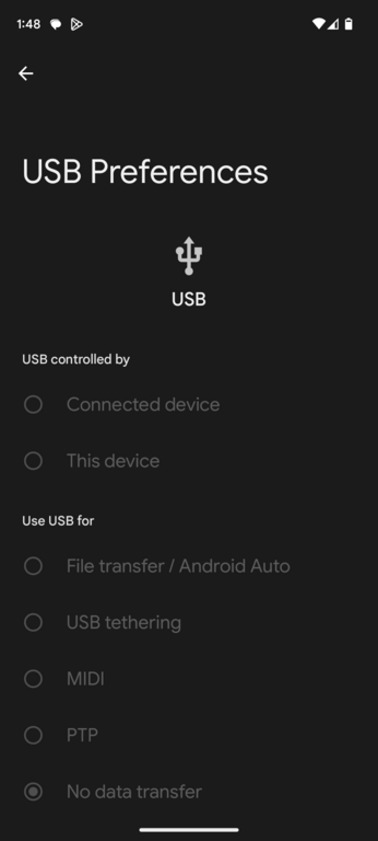

    Does your Flip have USB settings to play with?
    This is what I see on my Pixel 7:
    Click image for larger version  Name:	Screenshot_20231107-134807.png Views:	0 Size:	16.4 KB ID:	675082
    To be honest, I don't think I have ever connected my phones with USB for anything in ages, years even.. I just use Kdeconnect, though I am usually on wifi most of the time.
      I have pretty much those same options. It pops up repeatedly on the phone side as well, letting me know data transfer will be enabled and giving me the allow/deny options. But if I open the notification it takes me to a list of options that matches the screenshot above.
      I have "This device" and "Transferring files / Android Auto" selected. Though I did give it a shot with Connected device and/or Transferring images, it didn't seem to help much.
