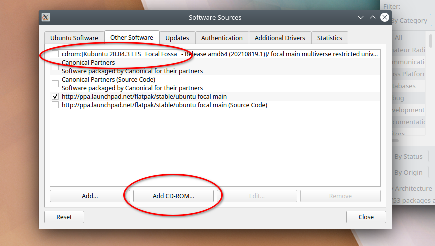

      The easiest way to use this is to grab your 20.04 installer disk, and plug it in. Open it in Dolphin to make sure it is mounted.
      Then open Discover, or Muon, and find the Software Sources tool.
      Under Other Software you will see some options highlighted below:
      Click image for larger version  Name:	Screenshot_20220424_190715.png Views:	0 Size:	178.2 KB ID:	662462
      I *think* this feature still works , don't think I have used it in over a decade maybe.
      The installer USB is still seen as a CD-ROM, just not sure iof simply checking the box for 'cdrom' or if you need to use the 'add cdrom'.
      Once that is done , you should be able to install build-essential and dkms
      I am still trying to find a pictorial or video of this being used. Multitasking here, as is my usual SOP
      I may try a demo if I can find a free moment or three.
      Nope, it does 't seem possible, it is looking for a physical optical drive (/dev/sr0), however the files ARE on the installer disk under /pool/main/
      I'd still suggest using Ethernet or wifi tethering, probably easier and less hassle, though again, all the dependencies are on the installer image, it would just be a bit tedious.
