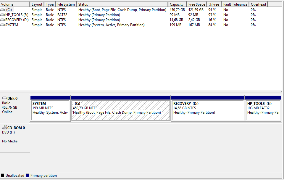

      I also have a new HP 64-bit computer. One thing to bear in mind is that Windows 7 takews 2 primary partitions up fron with the recovery partition and then the Windows partition. HP then has there restore partition and your left with one usable primary partition left. I install all my Linux stuff inside a logical partition. It just seems well more logical to me.
      Regarding whats sound and whats not. I find there are several ways to accomplish the same thing.
      Also I used a hack and removed Windows recovery/boot partition and now have Windows7 run under only one partition. Coming from years of the old way of doing things I suppose. It makes backing up much easier.
      First thing is to install gparted and you can then get a picture of how your hard drive is setup.
      I will give you a shapshot of an old partiton setup I used. I have since altered it a bit, but the underlying setup is the same. I always have an NTFS backup partition to store downloaded files and make backups to. Then I also use an external hard drive for save keeping.
        Are you telling me I deleted the wrong partitions? Good giref, I could die for shame. So you're saying I am going to have to do the whole windows plus Kubuntu install again, this time not using the build in partition tool but gparted? Oufff! I'll give it another try.

          No, I don't think I deleted the wrong partitions, because I found them. But I could not access them. Ie the Grub told me I had windows installed, but I got the famous error message (attached). Inserting the system rescue disk and clicking the equally famous "repair" did not produce any change.
          To capitulate: I have twice tried to install Lucid in a dual boot arrangement, both times using the partitioner in the install module. I have once installed Lucid on the entire hard disk, but got issues that will be dealt with in a separate post. I have tried to shrink using windows' own shrink function (totally inadequate, for one thing because it does not shrink enough.)

            Re: Dual boot - preinstalled windows 7 (64 bit), adding kubuntu lucid (64 bit) -
            Your C drive can be shrunk. Your only using 6% of it. I use either Acronis Dick Director or Gparted to resize. I defrag before I resize. I've done it hndreds of times without loss of data. Remember though - backup or clone your C drive first.

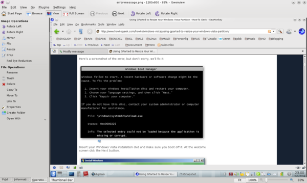

                            I reinstalled Kubuntu, this time using the 32 bit, Same result:
                            Grub seems ok, and ubuntu starts nicely. But windows will not run, and I get the error screen I know so well now (cf. attachment above).
